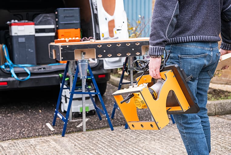

The UJK Portable Trim Router Table gives you a stable base to work with, wherever you are
*Designed for use with ¼” palm routers
Compact and portable
Weighing less than 7kg total, this table is completely portable and can be easily taken with you to different environments. Its compact size allows for easy storage, even in small workshops.

The front rail provides the ability to clamp to your workbench or other surface. You can also clamp to your multifunction table using dogs, ensuring your workstation is completely secure.
