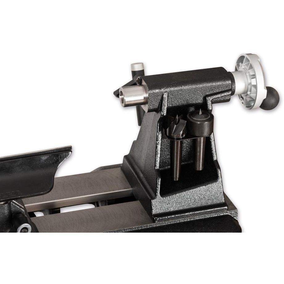

  • Heavy cast-iron bed for stability and reduced vibrations
  • Robust headstock, tailstock, and banjo construction
  • 1-step cam handle for fast belt changes
  • Self-ejecting tailstock with long quill travel
  • Forward and reverse rotation for enhanced versatility and finish
  • 24 position spindle indexing for precise positioning
  • Spring-loaded spindle lock for secure operations
  • Soft-grip cam action levers for comfortable handling
  • M33 x 3.5mm spindle thread

Powerful precision in every turn
From compact versatility to large-scale capability, each Laguna lathe is engineered with precision, power, and user-centric design for an unparalleled turning experience.
Cast-iron bed
Ensures stability and precision
Cast iron headstock, tailstock and banjos
Gives strength and low vibration
Belt change lever
Offers quick adjustment
For added versatility
Indexing positions
Improves detail in project designs
Enhanced safety
Projected nose cone with dual bearings
Gives additional accuracy and better work access

Laguna Revo 12|16 Woodturning Lathe is a perfect blend of strength, precision, and user-friendly features. Engineered for precision and ease of use, this lathe combines robust construction with innovative features to deliver exceptional performance. The heavy duty heavy cast-iron bed, headstock, tailstock and banjo ensures stability and reduces vibrations, providing a smoother operation on all of your woodturning projects. Whether you're a seasoned professional or a passionate hobbyist, this lathe offers the stability, versatility, and performance you need to achieve outstanding results.
One of the standout features is the 1-step soft grip cam handle that allows for quick and easy belt changes, saving you time and effort. The self-ejecting tailstock with long quill travel enhances the diversity and usability of your woodturning tasks. Additionally, the lathe offers forward and reverse rotation, giving you versatility in your turning operations. The machine will also take an accessory ASR locking ring that will give greater safety by locking the chuck and spindle together.
The lathe's speed is monitored and automatically adjusted to maintain a constant speed, thanks to the pulse width modulation system (PWM). This system delivers a series of voltage pulses to the motor, continuously monitoring and adjusting the speed to maintain a constant rate. This ensures an impressive level of torque, even at the remarkably low speed of 50rpm, resulting in an optimal performance at all times.
The digital speed readout allows you to monitor the speed accurately. The anodized aluminium plate features ergonomically positioned controls, and the tactile, rubber-augmented knurled aluminium dial provides smooth and enjoyable variable speed control. The projected nose cone improves stability by enhancing access to the workpiece and providing wider bearing spacing. This design helps to reduce vibrations and ensures a more stable and precise operation, especially during delicate tasks.
For precise positioning, the 24-position spindle indexing is a valuable feature, enabling detailed work and repetitive tasks. The spring-loaded spindle lock ensures secure locking for safe and accurate operations. The soft-grip cam action levers provide comfortable and secure handling during adjustments, while the hardened steel leading edge tool rest offers durable support for your turning tools.
Supplied with 2MT four prong drive centre, 2MT revolving tail centre, 75mm (3") diameter faceplate, 1.8m power cable with UK 3 pin plug. Unlock your full potential with the Laguna Revo 12|16 and take your woodturning craftsmanship to unparalleled heights.
